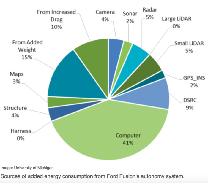

The power-consumption problem was highlighted recently with a report published by the the University of Michigan Center for Sustainable Systems. Its lead author, Greg Keoleian, questions whether the current autonomous car models will slow the overall adoption towards electric vehicles. Keoleian’s team simulated a number of self-driving Ford Fusion models with different-sized computer configurations and engine designs. In sharing his findings, Keoleian said, “We knew there was going to be a tradeoff in terms of the energy and greenhouse gas emissions associated with the equipment and the benefits gained from operational efficiency. I was surprised that it was so significant.”

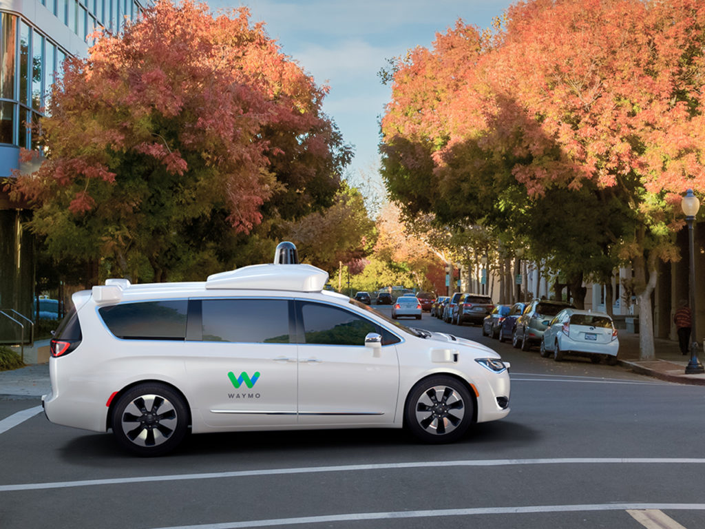

However, the University of Michigan tests only showed a “six to nine percent net energy reduction” over the vehicle’s lifecycle when running on autonomy mode. This went down by five percent when using a large Waymo rooftop sensor package (shown below) as it increased the aerodynamic drag. The report also stated that the greatest net efficiencies were in cars with gas drivetrains that benefit the most from smart driving. Waymo currently uses a hybrid Chrysler Pacifica to run its complex fusion of sensors and processing units.

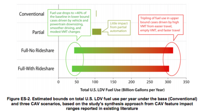

Keoleian told IEEE Spectrum that his modeling actually “overstates real impacts from future autonomous vehicles.” While he anticipates the reduction of computing and sensor drag, he is concerned that the impact of 5G communications has not been fully explored. The increased bandwidth will lead to greater data streams and boost power consumption for inboard systems and processors. In addition, he thinks that self-driving systems will lead to greater distances traveled as commuters move further away from city centers with the advent of easier commutes. Keoleian explains, “There could be a rebound effect. They could induce travel, adding to congestion and fuel use.” Koeleian points to a confusing conclusion by the U.S. National Renewable Energy Laboratory that presents two possible outcomes of full autonomy:
  1. A reduction in greenhouse emissions by sixty percent with greater ride sharing options
  2. An increase of two hundred percent with increased driving distances
