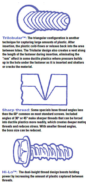

The U blunt-point type is a multiple-thread drive screw for permanent fastening. The U-type screw is not recommended for screw removal scenarios. For those instances, special thread forming screws such as the Trilobular™, which are designed to reduce radial pressure, can be used. Screws with non-circular cross sections have slightly higher driving and stripping torques.

The HI-Lo™ fastener is another unique thread form. It has a double-lead thread where one thread is higher than the other. Its sharp 30° included thread angle allows for a deeper cut into the material and reduces the hoop stress that would be generated by a conventional 60° thread-angle form. In addition, the Hi-Lo screw has a smaller minor diameter than a conventional screw.
The shape increases the material in contact with the high flat thread and increases the axial shear area. All of this contributes to a greater resistance to pull out and a stronger fastener. This type of screw can be either thread forming or thread cutting with the thread cutting variety used in most materials with higher absolute values.
