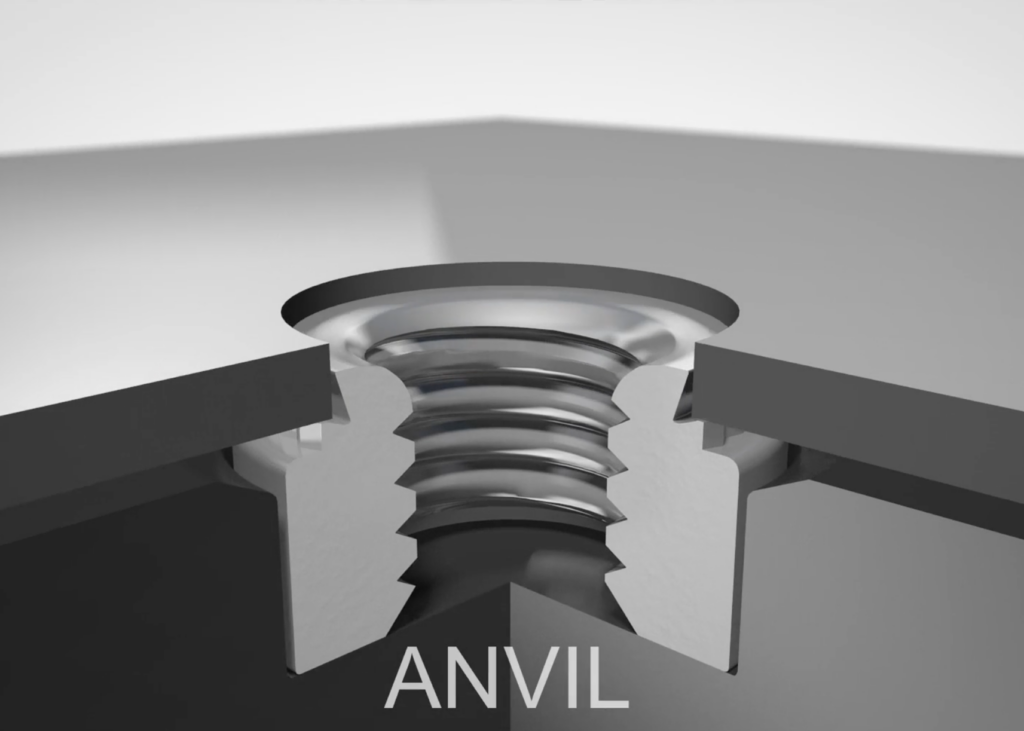

Self-clinching step 1: Place the fastener into the anvil hole and place the mounting hole over the shank of the fastener
When pressed into ductile material, a self-clinching fastener displaces the host material around the mounting hole, causing it to cold flow into a specially designed annular recess in the shank or pilot of the fastener. A serrated clinching ring, knurl, ribs, or hex head prevents fastener rotation in the host material once inserted — becoming a permanent part of the piece into which it’s installed.

Self-clinching step 2: With the installation punch and anvil surfaces parallel, apply squeezing force until the head of the clinch nut comes in contact with the sheet material.

In just three steps, self-clinching fasteners install with any parallel-acting press that can be adjusted to optimum installation forces.
  • Step 1: Place the fastener into the anvil hole and place the mounting hole over the shank of the fastener.
  • Step 2: With the installation punch and anvil surfaces parallel, apply squeezing force until the head of the clinch nut comes in contact with the sheet material.
  • Step 3: Install the mating piece from the side opposite the head of the fastener.
Self-clinching step 3: Install the mating piece from the side opposite the head of the fastener.
