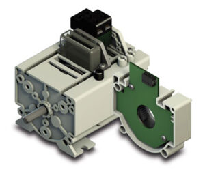

When human actors work in close proximity to moving loads, it is vital that motion stops in precisely the right position – every time. Geared cam limit switches from Stromag perform this role every day in many of the world’s largest and most famous theaters and TV studios.
The company’s Series 51 range is based on a unique planetary gear design that can map a wide range of shaft rotations to the angular displacements of the installed cam discs. They provide an ideal solution in applications where angles or distances cannot be directly limited by switchgear, but must be determined by the rotation of a shaft. Meeting the highest industry standards, the modular design, wide range of possible gear ratios (from 4.1 to 16,000 turns) and simple, precise adjustment make these units appropriate for numerous applications including hoists and spindle lifts.
