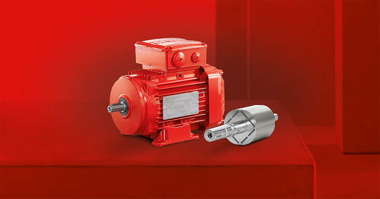

SEW-EURODRIVE is setting a new standard for efficiency with the launch of the DR2C motor, an IE5 ultra-premium efficiency motor engineered for wide speed range operation and maximum long-term energy cost reductions. Designed for industries focused on minimizing total cost of ownership (TCO), the DR2C reduces energy consumption, minimizes heat losses, and enhances operational reliability—delivering a fast return on investment and sustained savings throughout its lifecycle.
The SEW-EURODRIVE DR2C motor series uses Interior Permanent Magnet (IPM) technology, which integrates permanent magnets within the rotor instead of surface-mounted. This design increases torque density and achieves the highest normative efficiency class IE5, resulting in energy losses up to 50% lower than those of standard IE3 asynchronous motors in the same power class – achieving superior energy efficiency across the entire speed range. This leads to lower operating costs, extended service life, and reduced environmental impact—all without compromising power or performance.
The motor delivers maximum torque in a compact design, making it up to two frame sizes smaller than comparable IE3 asynchronous motors. This high-power density is achieved through advanced IPM technology, ensuring exceptional efficiency and performance for heavy-load applications. Additionally, the DR2C’s low inherent mass inertia minimizes energy losses during acceleration, further enhancing its dynamic response and overall efficiency.
motors
