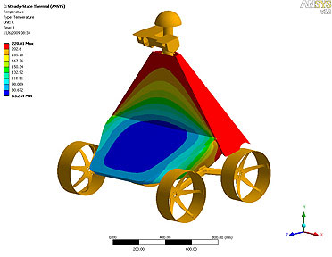

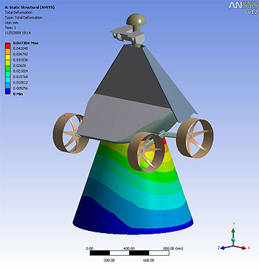

ANSYS FEA software simulates the robot from Astrobotic Technology under conditions of static structural loading, top, and steady-state thermal loading, bottom. Courtesy, Ansys.

“This is a race after all, so we are leveraging engineering simulation software from ANSYS to keep moving at warp speed,” said David Gump, president of Astrobotic. “We are applying the software to find the lowest-cost, lightest-weight designs for our robots and the deep-space transfer stages that will deliver them from Earth’s orbit to the Moon. ANSYS technology enables us to examine alternative structures and materials to rapidly find the most effective combinations via simulation, before we build physical prototypes.” For example, Astrobotic will use tools from ANSYS to design the composite structures of the landing stage and then model the impact forces it will experience when it touches down on the Moon.
Surviving the Moon’s environment, which exhibits drastic temperature changes, is proving to be a complex challenge. “The Moon is a harsh world to explore. At noon, for instance, our robots will be baked at 244 deg F, according to the latest readings from NASA. Our third prototype, created by our partners at Carnegie Mellon University, demonstrates how to beat the heat with an innovative asymmetrical shape. The software’s thermal analysis capabilities help us determine the optimal design to withstand the Moon’s elements,” Gump explained.
