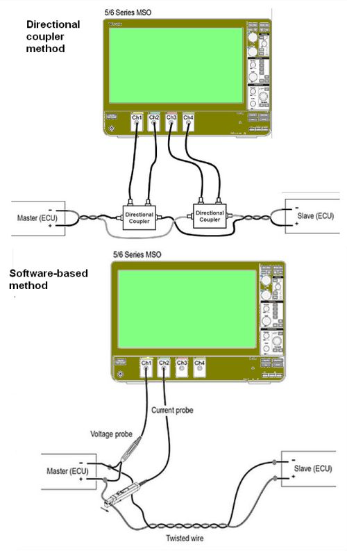

Currently, there are two methods for separating master and slave signals. The first, the traditional method, requires cutting the Automotive Ethernet cable and splicing a directional coupler in each wire of the twisted pair to separate and test the signals. Technicians must physically cut the cable to implement the test, which introduces accuracy problems.
separating automotive eithernet signals
Traditional methods for separating Automotive Ethernet signals employ directional couplers spliced into the twisted pair, top. New software-based methods allow a simpler setup using just and inductive current probe and a differential probe, bottom.
It is not easy to cut the cable, which makes this method less than ideal for most system-level testing applications. While this approach does provide access to the master and slave signals, it introduces insertion and return loss, which can make it difficult to determine if an error results from the additional hardware. And, while it is possible to remove the effects of the directional coupler, de-embedding (basically, removing the effects of the test fixture from the data) can amplify the noise in the system and degrade measurement and characterization accuracy.
More recently, test manufacturers have devised software and probes to non-intrusively separate the signals, allowing engineers to visualize the true signals with greater clarity. The connections involved consist of an inductive current probe monitoring one of the twisted-pair wires and a differential probe placed across the twisted pair.

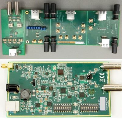

Because PHY frequencies are in the gigahertz range, test probes can cause line reflections and other distortions that can garble measurements. Tektronix recommends using its TF-XGbT Ethernet fixture (top) and TF-BRR-CFD clock divider fixture (bottom) to minimize distortion when making connections to Ethernet transmitter output and reference clock signals .
A distortion test defined in the spec requires access to the ECU clock, which is often impractical. A special software correction method eliminates the need for the clock connection for 100BASE-T1 and 1000BASE-T1.
