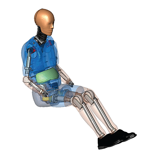

A crash dummy (real at top, FEA virtual
model at bottom) has a complex internal
structure and multiple sensors that
record up to 35,000 data points in a
typical 150 millisecond crash.

Simulating the crash simulator
Since a physical crash dummy is a manufactured product like any other, it is feasible to simulate performance with analysis (FEA) software. Given the power of FEA to cost-effectively reduce real-world testing, in the case of expensive crash dummies, and even more expensive vehicle prototypes, it definitely pays to simulate the simulator: You can crash a virtual car and dummy many times, much faster and at far less cost than a single physical test.
