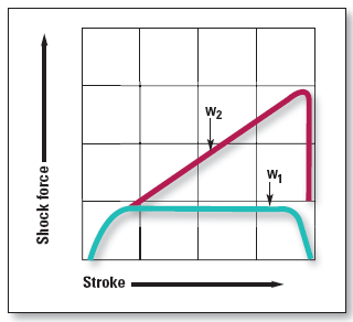

Shock absorbers have controlled and predictable deceleration. The moving piston pressurizes the fluid and forces it through the orifices, which heats the fluid rapidly. The heat conducts to the cylinder body and then to the atmosphere. Increasing the impact weight (from curve 1 or W1 to curve 2 or W2, with the velocity unchanged) increases the damping force at the end of the stroke
and the force transfers to the mounting structure and impacting load.
Various forms of damping can be used, each of which depends on the application. The differences in these damping characteristics relate to the efficiency of the damping used.  The efficiency is measured by evaluating how much of the stroke of the shock is used in the actual damping of the motion. Shock absorber efficiency increases as more energy spreads over the stroke of each one. The more efficient shock absorbers typically yield the lowest shock forces when the stroke of the shocks is equal.

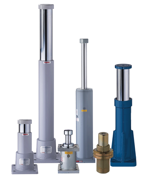

Enidine heavy-duty, large-bore hydraulic shock absorbers protect equipment from large impacts in various applications such as in automated storage and retrieval systems, overhead bridges, and trolley cranes.
The graph illustrates two different shock curves. The amount of energy absorbed in both cases is identical. However, curve number 1 uses the highest percentage of available stroke to absorb the energy and is the most efficient. Curve number 1 also occupies the lowest point on the curve, which is the minimum shock force and may be the most desirable.
