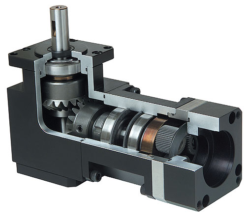

Considering the need for a gearhead early in the design stage of a motion application will save time and effort (and headaches) further down the road.
When designing a motor into a motion control system, all too often the benefits of a gearhead are realized much too late. Designing in a gearhead at the end of the project will many times cause delay and additional cost, which could have been prevented if it had been considered at the start of the project. Understanding all of the advantages that a gearhead provides can help you design a successful motion control project.
Consider these six tips to help you select the proper planetary gearhead for your motion control application.
1) Consider a gearhead early in the project
All too often, when designing a motor into a motion control system, cost is generally the driving factor that influences the design. In keeping what is thought to be auxiliary components to a minimum, a gearhead is often disregarded in hopes that the motor itself can handle the application. However, in many cases, the necessity of a gearhead is understood when the use of the motor (alone) then presents challenges, and it is usually at about the time the project is due to ship to the customer. After the initial design oversight, a gearhead is then determined to be required and it usually needs to be applied into a space that originally was never intended to accommodate a gearhead. In short, the cost of redesigning a motion application to incorporate a gearhead afterwards will usually prove more expensive than if it was designed in from the start. In particular, planetary gearheads have some distinct benefits in motion control applications. They can offer improvements in system response, inertia matching, speed matching, system stiffness, and system resolution.
