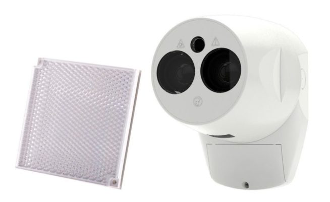

A: Auto-aligning optical-beam smoke detectors are also in use. In these, the smoke detector is a laser-assisted infrared optical beam between the laser source and optical receiver (Figure 2). Rather than being single-point, localized smoke detectors, these units sense across a larger distance, somewhat analogous to free-space optical links (see EE World Related Content).
They protect large commercial and public spaces such as theatres, shopping malls, and sports centers with large skylights, lofty ceilings, or condensation issues. The optical receiver can be placed at the far end of the beam path, or it can be co-located in the same housing as the light source, with a reflecting mirror at the far end. The former approach supports a longer span but also requires wiring at the far end instead of a simple mirror.
