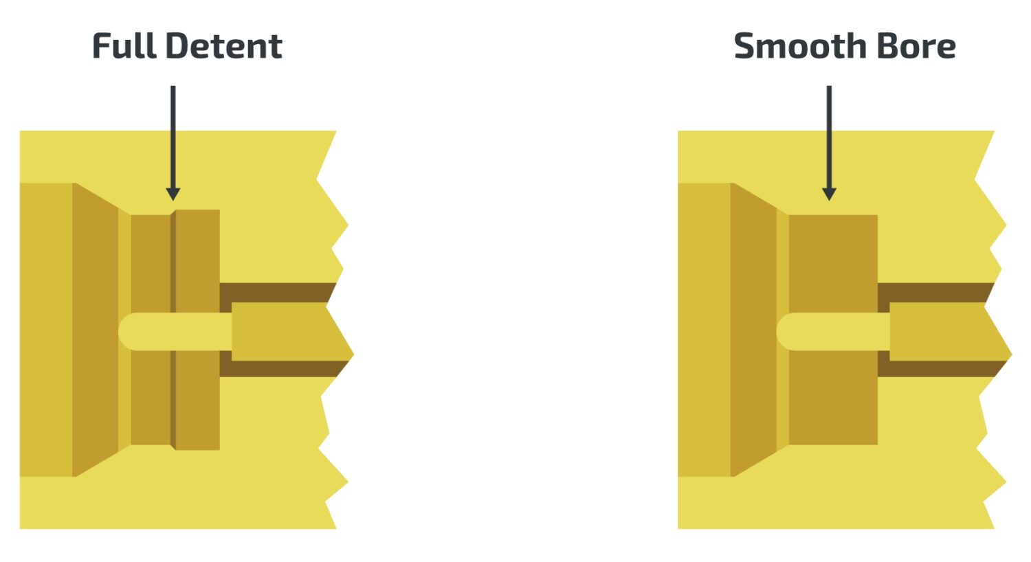

One side of the connector has full detent so that bullets are held fast once inserted (detent is the amount of force necessary to connect or disconnect). It is entirely possible to remove bullets from a socket with full detent, but the point of full detent is to make such removal difficult deliberately. The other side of the connector will be engineered to have a lower degree of detent. Different connector lines can offer two levels: full detent and smooth bore (Figure 3). If the two sides are disconnected, deliberately or inadvertently, the bullets should consequently all stay with the side of the connector with full detent. This keeps bullets from being lost and preserves the orientation of the bullet(s) so that reconnection can be accomplished correctly and swiftly, which can be especially important when using dual-port connectors.
Figure 3. Comparison of full detent and smooth bore receptacle types.
