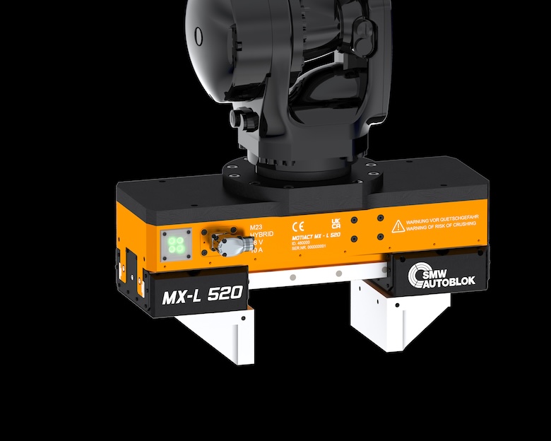

The MX-L 520 has a maximum stroke per jaw of 99 mm and repeatability at ± 0.02 mm. Image: SMW Electronics
The Motiact gripper series is suitable for performing precise, consistent, and accurately monitored gripping operations for moving parts, pallets, and chucks in and out of CNC machines and automated work cells. They are equipped with an incremental measuring system to guarantee adjusting gripping pressure, linear positioning, and speed control as standard features. All models are available with a Profinet, Ethernet IP, Digital IO, or I/O link interface to ensure seamless integration into existing systems. The series affords easy job changes with unattended operation to minimize downtime and increase productivity.
Motiact mechatronic grippers can be used for sensing, loading, and unloading various types and sizes of parts and any scale of movement tasks. The MX-S small parts, MX-M universal, and MX-L long-stroke grippers that are suitable for moving large loads safely in the automation process and are up to IP67 rated for high durability in any environment. The MX-S grippers also come with a high-speed variant for better efficiency and performance.
The MX-L 520 mechatronic large-stroke gripper provides gripping forces ranging from 10 to 40 kN, a large jaw stroke, pre-positioning, and clamping force adjustment. The MX-L 520 ensures safety and reliability in the event of a power failure. The large gripper has a maximum stroke per jaw of 99 mm and repeatability at ± 0.02 mm for better precision and control.
