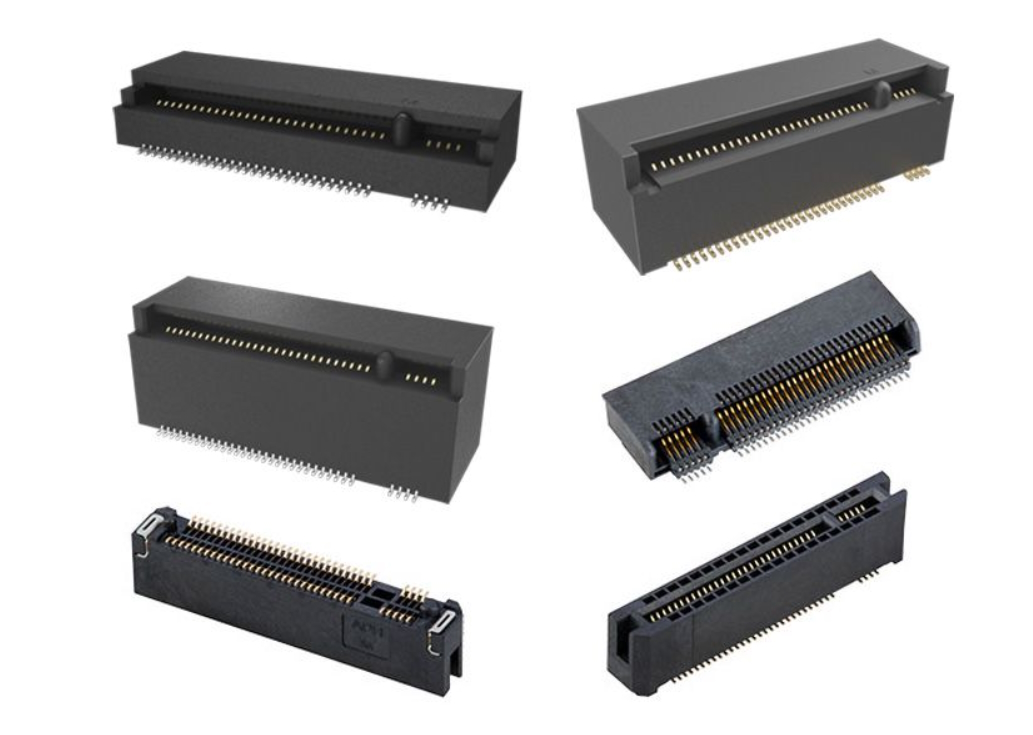

PCIe M.2 Gen 5 connectors are available with 67 contacts on a 0.50 mm pitch. These connectors support single- and double-sided modules. They require less board space compared to mPCIe connectors (Figure 2). Other features include:
  • Variety of connector heights and keying options
  • Accept angled insertion of modules
  • Choice of right-angle or vertical orientations
Figure 2. These PCIe M.2 Gen 5 Connectors have 67 contacts on a 0.50 mm pitch. (Image: Amphenol)

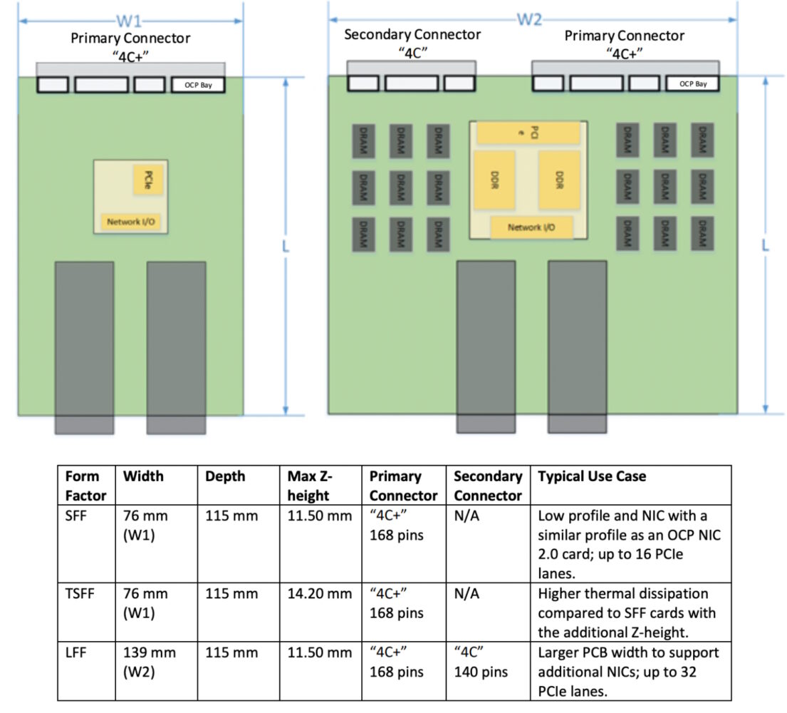

The OCP NIC 3.0 specification includes three form factors: Small Form Factor (SFF), tall small form factor (TSFF), and large form factor (LFF). The SFF and TSFF can include up to 16 PCIe lanes, while the LFF can include up to 32 PCIe lanes (Figure 3). The SFF and TSFF configurations can handle up to 80W to the NIC, while the dual connector LFF configuration can handle up to 150 W.
Figure 3. Configurations and basic specifications of OCP NIC 3.0 SFF/TSFF (left) and LFF (right). (Image: Serve the Home)
OCP NIC 3.0 works with PCIe Gen 4 (16 Gb/s) on the baseboard and OCP NIC 3.0 card and is electrically with PCIe Gen 5 (32 Gb/s). It can handle up to 32 lanes of PCIe per OCP NIC 3.0 card and supports single-host, multi-root complex, and multi-host environments. The next iterations are expected to support differential pairs up to 64 G PAM4 and the ability to upgrade to 112 G PAM4 and 224 G PAM4 further in the future.
