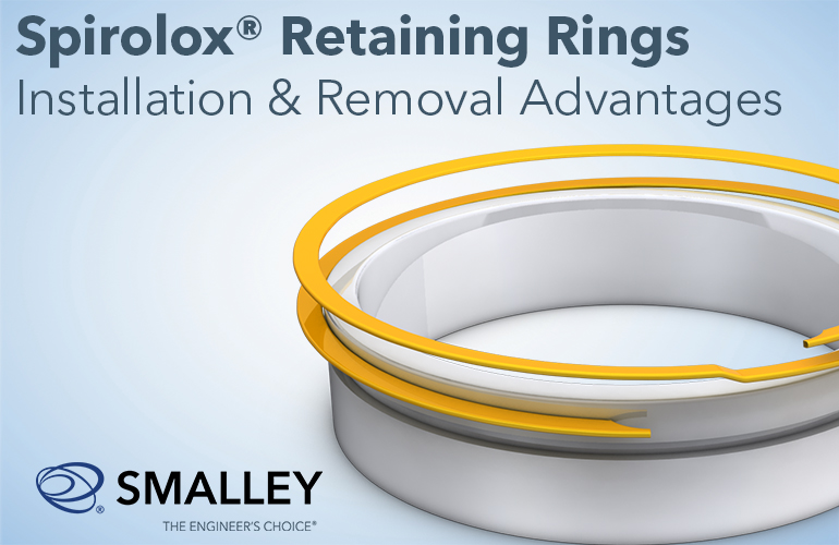

What are Spirolox retaining rings used for?
Retaining rings serve as a removable shoulder within an assembly to literally retain components in a bore or on a shaft.
How are these retaining rings made?
Spirolox® retaining rings from Smalley are specifically coiled on edge from rectangular cross-section flat wire as opposed to rings that are stamped from a sheet. Common materials used are carbon steel and 302 stainless steel. These rings consist of one or more turns depending on the force and strength needed within an application. The rings can be edge-wound to nearly any custom diameter—a huge advantage over die-stamped components that require tooling. Multiple turn rings eliminate the gap, providing a full 360 degrees of contact.
Are these retaining rings difficult to install?
Not at all. The rings can be inserted by hand and easily wound into a groove. The easiest method of installation is to separate the multiple coils and insert an end into the groove. Then press down around the circumference and wind the ring into place.

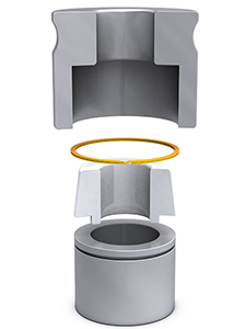

Can this be done using an automated process as well?
Semi-automated and automated installation is possible. For example, in an internal grooved application, a plunger and tapered housing sleeve (suggested taper of 6 degrees) are used. The sleeve acts as a guide, while the plunger pushes the retaining ring into position.
For external applications, a plunger and tapered plug are used for installation. First, the plug is centered over the shaft end (again at a suggested taper of 6 degrees). The plunger fits loosely and pushes the ring into position over the plug. The same sleeve or cone with a plunger concept can be applied for fully automated assembly as well.
We’ve talked a lot about installation, but how easy are the retaining rings to remove?
Spirolox retaining rings feature removal notches for extraction from within a groove. No special tools are required. The notch creates a gap between the end of the ring and the shaft or housing, which allows an object, like a screwdriver, to be inserted into that gap to pry the ring free. Once the first end of the ring is pried out of the groove, grab the ring and spiral it out just as easily as it went in. For removal where clearances are very tight, consult a Smalley Engineer for the best option for your specific situation.
