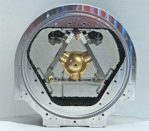

Comsol2
Actual hardware.

“The radiation source temperature can be set between 95 and 300 K to generate radiation—this creates a large temperature differential between the source and the 4.5 K environment, while available cooling power at these temperatures is limited to just tens of milliwatts,” de Jonge explained. “To account for this, we needed to design a thermally insulating suspension system.” The SRON team needed a stiff suspension with a high resonance frequency that would prevent heat transfer from the source to the rest of the device while also protecting it from unwanted vibrations.
Comsol5Designing a thermally insulating suspension system
Using COMSOL simulations, de Jonge evaluated the heat load through the suspension and performed modal analyses on suspension concepts with different geometries and materials, seeking a tradeoff between mechanical stiffness and thermal load.
“Because of the large temperature gradient over the brackets and thermal properties that change very quickly as a function of temperature, temperature-dependent material properties had to be implemented,” he said. “Ultimately, we chose the solution that had the best combination of mechanical stiffness and thermal insulation.”
Based on the results, the team designed and optimized a configuration of thin (100 µm) stainless steel wires to hold the radiation source to a triangular frame.
Because stainless steel has low thermal conductivity at cryogenic temperatures and the cross-section of the wires is very small, heat conduction through the wires was limited, which the simulation confirmed. For a source temperature of 150 K, the experimental analysis showed 10.17 mW of conducted heat. The simulation results were in close agreement, accurate to within 0.01 mW. The design also had a resonant frequency of 720 Hz, high enough to ensure proper functioning of the radiation source.
