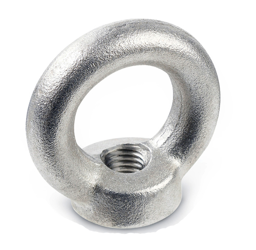

J.W. Winco, Inc. now offers series DIN 582-NI Stainless Steel Lifting Eyes with tapped thru hole, in metric sizes. These metric sized, RoHS compliant lifting eyes are manufactured with the contact face machined to allow for firm contact with the mating surface. The stainless steel material and one piece design makes these components suitable for use in food, medical or other clean room applications.
A range of six metric sizes is offered, with tapped threads from M8 to M24. Maximum loads for one bolt range from 1350 to 17,600 N, and with two bolts jointly from 950 to 12,600 N. A steel version is also available as well as a stud type version, DIN 580 series.
