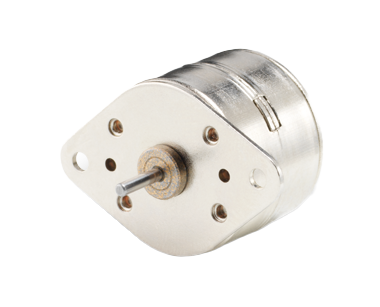

Can stack technology achieves reasonable accuracy and moderate torque. Image: Portescap

In addition, stack stepper motors can also be advantageous for some electronic expansion valve applications. This permanent magnet stepper motor uses simple techniques and designs to create an effective solution with reasonable accuracy and moderate torque. Customization might be required as part of the motor specification, particularly to enhance design integration. Features such as customized mounting plates, output pinions, and modifications to the motor itself might be necessary.
