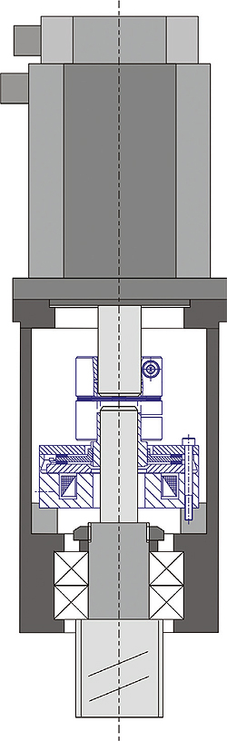

fast-switching-brake
In contrast to an integrated motor brake, where the braking torque is transferred via a coupling, the fast-switching brake has a direct effect on the ball screw spindle. The motor can be removed without loss of the brake function.
On certain fast switching brakes, this positive side effect becomes important. These spring-applied, electromagnetic fail-safe brakes are installed in machine tools on the ball screw spindle in the bell housing. In order to reduce the generation of heat through the magnetic coil to a minimum, the brake was constructed for low power consumption. By controlling the brake via a control unit, the power consumption could be reduced by a further 75%. Although the fast-switching brake is directly installed on the ball screw spindle, the heat generated by the coil power can be neglected, and doesn’t affect the accuracy of the machine.

The main focus of this application, however, is the extremely quick switching behavior of the brake. On power failure or emergency stop, the fall path of the carriage is an important consideration. The fall path is mainly dependent on the brake switching times and so it’s been optimized especially for short switching times. The fact that the switching time is halved reduces the fall path by 75%. In many cases, this is enough to prevent critical damage to machine components or workpieces after a power failure. Mayr’s ROBA-stop®-M fast-switching brake also increases safety. In contrast to an integrated motor brake, where the braking torque is transferred via a coupling, the fast-switching brake acts directly on the ball screw spindle. This means that the motor can be removed without the loss of braking function.
