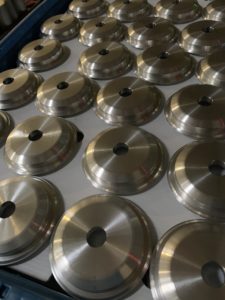

Staub Precision Machine recently chose CERATIZIT reamers to perform a finishing operation of high-precision holes to size. The reamer was a solid carbide PCD tipped (polycrystalline diamond) with a through-tool coolant diameter of .626-in. +.0005 -.0000. The material cut was aluminum, and the production run quantity was 2,500 parts per week. In addition, Staub designed and machined two tombstones as well as collets. There were 33 parts on each of the four sides of the tombstone in the machine, and Staub made 132 parts at a time. The machine was running at 4900 RPM and 78-in. per minute feed. The hole was only .250-in. deep, taking less than a second per hole to ream.
Additionally, the hole was .616-in. before reaming, leaving .010-in. of stock allowance. While the hole has a .0005-in. tolerance, the reamer cuts the same size every time with a high mirrored finish (See photos 1 and 2).
