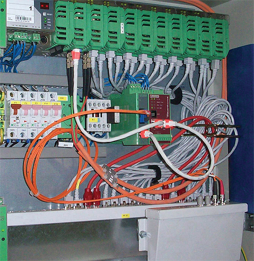

sensitive-production-systems
Sensitive production systems tend to be inadequately protected. Imported malware or unintentional incorrect misentries on the internal network cannot be prevented by central

From Jens Hoofdmann‘s perspective, installing, setting up and integrating the industrial firewalls was easy. The devices were used in a distributed manner in control cabinets for every uplink connection. In hardware terms, Volkswagen AG was able to mount the 24-V DIN rail devices directly into the control cabinets and allow its own staff members to start them up based on the existing network structure and without any re-cabling operations.
