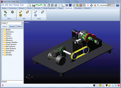

Fig 1. Adams/Machinery includes wizards for rapid design and analysis of machine subsystems, such as gears, belts and pulleys, and chains and sprockets. While Adams has long supported analysis of these types of subsystems, Adams/Machinery makes the process much easier and faster.

Adams/Machinery is a set of productivity modules, bundled into a single offering. It runs in the standard Adams/Studio environment (Adams/View, Adams/Solver, and Adams/Postprocessor), and can import geometry from most major CAD systems, or build a solid model of the mechanical system from scratch.
What sets Adams/Machinery apart from plain Adams is the capability for wizard-based modeling, and adjustable-fidelity simulation of common mechanical subsystems, including gears, belts, and chains.

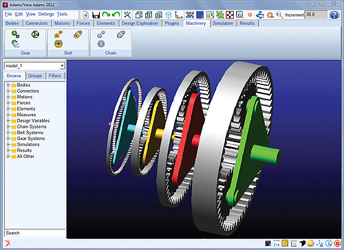

Adams/Machinery includes a wizard to automatically create planetary gearsets. They can also be created manually, without much difficulty.

Gears

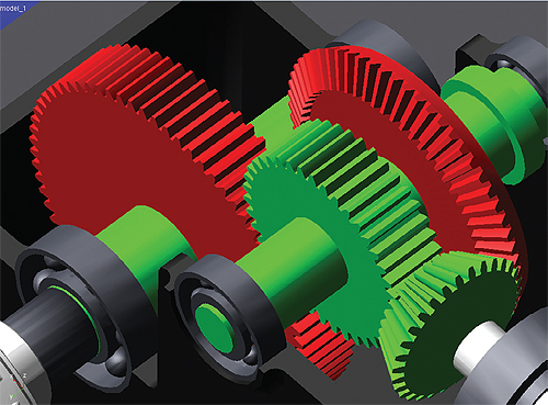

The Gears module is for engineers who need to predict the impact of the design and behavior of gear pairs, such as gear ratio and backlash prediction, on the overall system performance.
Gear-module-in-Adams_Machinery
The Gear module in Adams/Machinery supports spur, helical, and bevel gears, and provides multiple levels of analysis fidelity, depending on your needs.
The Gears module supports spur gears (internal/external), helical gears (internal/external), and bevel gears (straight/spiral). It includes a number of modeling methods, which users can choose from, depending on their analysis and fidelity needs:
Coupler method: When forces and components involved in it are neglected, and only speed reduction or multiplication is of interest.
Simplified modeling method: When friction is neglected, to have a fast calculation of the contact force.
Detailed modeling method: When friction is considered, to study the backlash based on actual working center distance and tooth thickness, or to capture the effect of variation of loading between 1 to 3 teeth, to calculate contact up to three teeth at the same time.
Contact modeling method: To use geometry-based contact, supporting shell-to-shell 3D geometry contact.

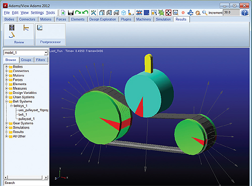

Belts
The Belts module is for engineers who need to predict the impact of the design and dynamic behavior of planar pulley-belt systems, such as transmission ratio, tension and load prediction, compliance studies, or belt dynamics, on the overall system performance.
belt-module-in-Adams_Machinery
The Belt module in Adams/Machinery supports Poly-V grooved, trapezoidal toothed, and smooth belts. It can calculate transmission ratio, tension, load, compliance, and belt dynamics.
The Belts module supports Poly-V grooved belts, trapezoidal-toothed belts, and smooth belts. It includes the following modeling methods:
Constraint modeling method: When forces and components involved in it are neglected, and only speed reduction or multiplication is of interest.
2D Links modeling method: To calculate the contact forces between the segments and pulleys when the axis of rotation is parallel to one of the global axes.
3D links modeling method: To calculate the contact forces when the axis of rotation is not parallel to one of the global axes.
Also included in the belts module is modeling for pulleys and tensioners.

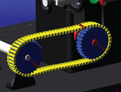

Chains
The Chain module is for engineers who need to predict the impact of the design and behavior of planar chain systems, such as drive ratio, tension, contact forces, or chain dynamics, on the overall system performance.
chain-module-in-Adams_Machinery
The Chain module in Adams/Machinery supports both roller chain, and silent chain. It can calculate drive ratio, tension, contact forces, and chain dynamics.
The Chain module supports both roller chain and silent chain. It includes these modeling methods:
Constraint modeling method: When forces and components involved are neglected and only speed reduction or multiplication is of interest.
2D Links modeling method: To calculate the contact forces between the links and sprockets when the axis of rotation is parallel to one of the global axes.
Also supported are linear, non-linear, and advanced compliance for roller chains, and linear compliance for silent chains. Sprockets are defined by location, geometric parameters, and material. Guide types can be pivot, translational, or fixed.

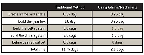

In truth, there’s nothing fundamentally new about the capabilities of Adams/Machinery. You can model gears, belts, and chains in Adams without using Adams/Machinery. It’s just that you can do it faster and easier with Adams/Machinery. Yijun Fan, MSC Product Marketing Manager for Adams/Machinery, points out that belt systems that would take even a very proficient Adams user a week to create could be created by a typical design engineer in about an hour using Adams/Machinery.

The time savings when creating multibody dynamics models with Adams/Machinery can be substantial. This table shows the approximate time to model the machine of figure 1, using the traditional method, or using Adams/Machinery.
