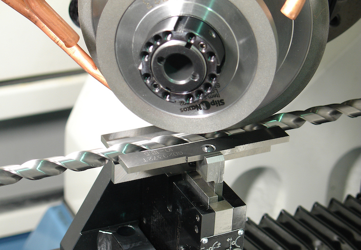

One use of CNC machining is in the manufacturing of long drills. The machining of long drills presents several difficulties and challenges in the production process. Their elongated physical size is not the only concern; ensuring accuracy throughout the entire length of the tool can be equally challenging. The extended nature of these drills introduces a host of potential issues that need to be addressed.
One challenge is the need to control grinding forces consistently throughout the entire length of the tool. This is crucial because long drills are designed to create holes that are not only accurate but also maintain their straightness over extended distances. The reduction of deflection caused by grinding forces is important. When fluting the drill in the shortest possible time, high feed rates and forces are necessary. It becomes crucial to find ways to minimize deflection while maintaining the required machining efficiency.
Another concern is runout, which refers to the error that occurs when the tool deviates from the center axis at an angle. While a standard setup may allow for an acceptable 5-µm runout for a 100-mm tool, the same setup could result in up to 40-µm runout for a 400-mm tool. Achieving acceptable runout becomes a priority when dealing with such lengthy tools, as it directly impacts the performance of the tool.
Additionally, long drills often feature coolant holes integrated within their bodies. To ensure proper functioning, these coolant holes must be correctly identified by the machine during the machining process, avoiding any damage that could impede their functionality. Managing grinding forces and preserving the integrity of coolant holes are critical considerations when working with long drills.
Addressing the challenges of tool deflection, runout, fluting, and coolant holes, integrated solutions and software capabilities provide a comprehensive approach to effectively produce long drills with accuracy and efficiency.
Spindle solution
ANCA’s TX7 CNC machine integrates a number of solutions to solve the challenge of producing long drills. First of all, the machine’s 37-kW (49-hp) direct-drive spindle facilitates the efficient grinding of long drills without putting excessive strain on the machine. It boasts a spacious working envelope and a 6th axis with a traveling steady support that can be positioned strategically to provide support in the grinding zone, allowing for the accommodation of tool lengths of up to 480 mm. This setup eliminates deflection and minimizes vibrations caused by grinding forces on the tool. It also addresses the issue of runout, as the steady supports enable compensation control to mitigate runout errors effectively.
