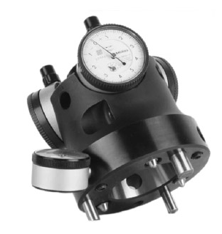

The Taper Shank Test Fixture quickly checks toolholders for distortion caused by retention knob installation.
Development of the patented product was key to identifying the inherent flaw design in v-flange tooling. This discovery was ultimately the driving force for the creation of their patented High Torque retention knobs, which are longer than traditional knobs and feature a precision pilot to increase rigidity, and a relief below the flange that forces threads into a deeper cross section of the toolholder. This eliminates the toolholder expansion responsible for costly and ongoing CNC milling and boring issues.
Key integrated design features include:
▪ Precision gages that read in increments of 1/10,000 of an inch.
▪ Ground to mirror a machine spindle.
▪ Three top dial indicators read the height off the flange and two side dials read taper movement.
▪ Sizes: 30 / 40 / 45 / 50 / 60 Taper
Proper retention knob installation is crucial to toolholder performance. Overtightening the retention knob may damage and unnecessarily stress the knob leading to premature failure. It also exacerbates the effects of toolholder expansion. A quick, simple test using the Taper Shank Test Fixture can be performed on a toolholder with a retention knob already installed.
Following the manufacturer’s instructions to fit the fixture and zeroing out the indicators for a base reading, and then loosening the knob for a second reading, will return an immediate indication of whether or not the holder has experienced expansion. The good news is that an expanded toolholder does not need to be removed from service and scrapped. Once the retention knob has been removed, the toolholder should return to its original state and can be used with a High Torque knob tightened to the correct torque spec.
