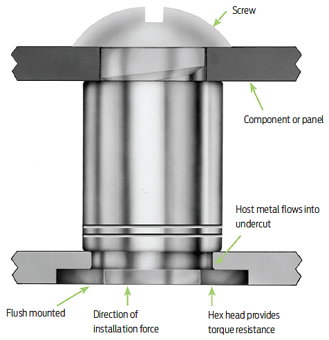

Self-clinching fasteners deliver time-tested solutions for attaching thin metal assemblies. Regardless of type, these fasteners install permanently in thin ductile metal sheets when pressed into place in a properly sized hole with sufficient squeezing force. The fastener’s serrated clinching ring, knurl, ribs, or hex head is embedded into the panel surface, displacing sheet material into a specially designed annular recess in the shank or pilot of the fastener, known as an undercut. The metal displaced into the undercut secures the fastener against axial movement, while a non-round displacer secures the fastener against rotation, resulting in the fastener’s permanent installation.

Push-out values will indicate the axial resistance of a fastener to remove it from the metal sheet opposite to the direction from which it was installed – in short, assessing the axial holding power of the fastener’s clinch feature. In general, the axial resistance of a fastener should be approximately 5% to 10% of the force used to install it.
In a typical installation, the self-clinching fastener’s undercut is filled (or nearly filled) with material from the host metal panel, which allows the panel material to make contact with the back taper of the fastener’s shank. Optimum push-out performance will be created when the force to dislodge the fastener’s displacer combines with the force required to clear the panel material from the undercut.
Conversely, reduced push-out will occur if the hardness differential between the fastener and host metal panel is insufficient – resulting in deformation of the fastener’s displacer and only partial filling of the undercut. In this case, the force to clear the panel material from the undercut will peak after the force to dislodge the embedded displacer, resulting in lower push-out.
