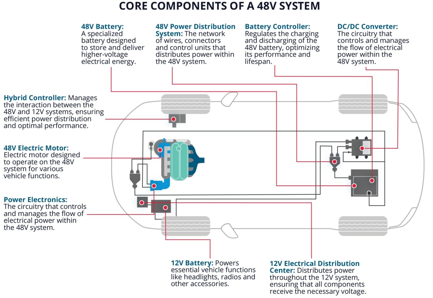

Here’s a compelling argument for what’s ahead in upgrading to 48 V systems (Figure 1). Delivering 1 kW of power requires approximately 83 A in a 12 V system, compared to around 21 A in a 48 V system. Transitioning 12 V to 48 V also allows for thinner, lighter wires, resulting in up to an 85% weight reduction for individual high-current power cables. These savings significantly reduce vehicle weight and improve overall system efficiency, especially in applications where heavy-gauge wiring dominates.
Figure 1. The core components of a 48 V power system include some 12 V components.
The lower current in 48 V systems also reduces heat generation, simplifying thermal management and improving system efficiency. In contrast, high current in 12 V systems generates more heat, requiring thicker cables and additional cooling solutions. While 12 V systems often rely on heat sinks and forced cooling to manage higher current paths, 48 V systems allow for smaller cooling solutions, such as localized thermal pads, due to reduced heat dissipation needs.

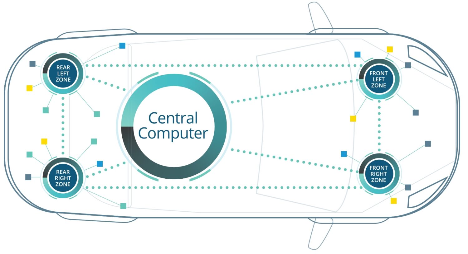

The decentralized approach of zonal architectures paired with 48 V systems simplifies wiring complexity and improves vehicle design flexibility (Figure 2). By distributing control to localized zone controllers, zonal configurations significantly cut wiring lengths compared to traditional centralized platforms.
Figure 2. In a zonal architecture, local computers collect data from sensors and send the data to a central computer.
In centralized architectures, parking sensors in the rear bumper might require 3 m of wiring to reach a central controller. With zonal controllers, those same sensors connect to a nearby controller using only 0.5 m of wire, thus reducing vehicle weight. Shorter wires also use less space, which simplifies assembly. Localized power delivery reduces electromagnetic interference (EMI) through shorter wiring runs.
48 V systems complement zonal designs using smaller, lighter cables that deliver sufficient power to localized controllers. While zonal architectures introduce challenges, such as advanced controllers and more complex fault isolation, the benefits of reduced wiring complexity and vehicle weight outweigh these tradeoffs. Table 1 summarizes engineers’ tradeoffs when designing zonal versus centralized architectures, emphasizing wiring complexity, modularity, and EMI management.
