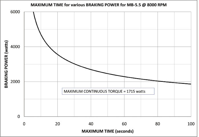

All of the braking energy dissipated by the brake is turned to heat in the drag ring. The heat is generated by both hysteresis and eddy current effects. It should be remembered that the eddy current effect is zero at zero speed. Eddy current effects increase with the drag ring thickness–the difference of the drag ring outer diameter and inner diameter divided by two; the MBS magnetic brakes have a substantially thicker drag ring than most commercially available magnetic brakes.
The transient, or short term, heat dissipation is largely a function of the thermal inertia of the drag ring. In many applications, such as decelerating a 3-ft diameter roll of film to a quick stop, very short term high-energy dissipation is essential. As an example, the Magnetic Brake Systems model MB-5.50 with a 4.56-in. drag ring diameter can dissipate 4,700 W, or about 6 hp, for a period of 10 sec, figure 4.
maximum braking times
FIGURE 4: Maximum times allowed for various braking torques at 8000 RPM.
Steady state, or continuous, power dissipation is largely aided by the impeller and ventilation holes shown in figure 1. The impeller, or centrifugal blower, creates a slightly negative pressure at the ventilation holes relative to the ambient pressure. This negative pressure forces airflow through the ventilation holes. The pressure produced by the impeller varies with the square of the angular velocity of the impeller. This phenomenon fortunately works in our favor. It should be remembered that power is a product of torque and angular velocity. Thus, when the brake is running at very low speeds there is essentially no heat being generated; at maximum speed the power is at maximum and the airflow is at the maximum.
In order to obtain maximum power dissipation from a brake it should, either through gears or belts, be geared up to run at maximum allowable speed.
