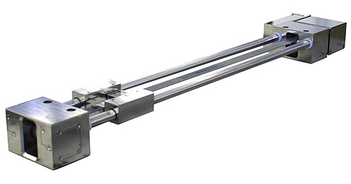

Turning the motor’s power into linear motion is the job of the mechanical transmission of the device. For single-axis electromechanical actuators, this typically comes by one of three means: Linear motor, belt, or screw drive.
Linear motors are the most technologically advanced and efficient method of directly transmitting the power of the motor into the motion of the actuator. Instead of the rotor rotating in the stator, the rotor travels in a linear, flat-array fashion along the stator. Typically found in base slides, any additional mechanics exist for support of the external load. Base slides powered by linear motors can exhibit extreme speed, stroke, and accuracy with moderate to high thrust capability. In addition, with appropriate controls, two completely independent saddles can share the same base slide axis. Maintenance is low, but due to advances in technology, it has a high level of initial investment.
The use of a belt drive is another alternative for high-speed linear actuation. An efficient mechanical means of transmission, a pinion attached to the output shaft of a traditional motor or gear head drives a timing belt. Often used in rodless cylinders and base slides, this timing belt directly transmits power to the saddle of the actuator. Much simpler in technology than the linear motor, these actuators require less investment and can still obtain extreme linear speeds. Because the motor is separate from the drive, the mechanical advantage can be used to increase thrust speed for actuator optimization. The disadvantage to belts is that they wear over time and require maintenance.
Screw drives, commonly found in rod-style actuators and rodless cylinders, are the last group of power transmission mechanics. With screw drives, a motor transmits power through a coupler or pulley arrangement to rotate the screws and translate a nut along the axis of the screw. Attached to this nut is either the rod or saddle of the actuator.
Screw drives come in three types: Roller screws, ball screws and lead screws. Roller screws are the most expensive to produce and most advanced of the group. These screws are used in applications demanding extreme thrust and life.
Ball screws are less complex using recirculating ball bearings to transmit moderate to high thrusts and speeds with high efficiency and duty cycles.
Lead screws are the simplest in design and complexity, relying on material properties to overcome the friction inherent in their nature. Although not as efficient or able to operate at high duty cycles, lead screw simplicity offers a cost effective method of driving an actuator.
All screw drives exhibit some stroke and speed limitation due to the inherent physics of their design (rod deflection and screw whip experienced at high rotational velocities), but mechanical gearing between the motor and screw, in addition to the choice of the screw lead, makes this method of drive attractive. Maintenance for the screw drives is moderate; yet, they require re-lubrication at specified intervals dependent on the application.
