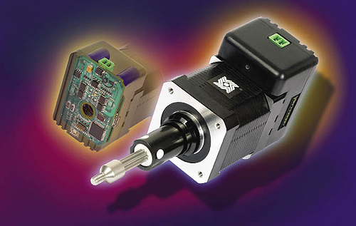

idea drive
The IDEA programmable actuator from Haydon Kerk is an example of cutting-edge intelligent chopper drive technology. IDEA consists of an advanced microstepping chopper drive with an intelligent programmable controller mounted to the rear section of a hybrid stepper motor linear actuator in one fully integrated package.

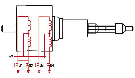

Unipolar drives have simple output configurations and are used infrequently due to the relatively low torque output and low efficiency. A unipolar drive contributes to a torque reduction of approximately 30% as compared to a bipolar drive at the same electrical power. In a unipolar drive, only half the phase winding is energized at one time, whereas in a bipolar drive, the entire phase winding is energized.
A unipolar drive configuration. Notice that the motor phase winding is center-tapped, thus allowing current to flow through only half the phase winding at a time.

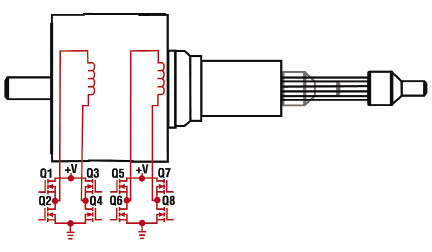

A bipolar drive configuration.
Bipolar drives have more complex output stages. Many of the new specialized integrated circuits have come down in cost, making bipolar drives more affordable. The output configuration is an “H-Bridge” which allows the reversal of the phase currents. Instead of the phase currents being switched on and off in just half of the windings like in a unipolar configuration, the currents flowing through the entire motor windings are reversed in bipolar drives. At equal electrical power into a given frame size stepper motor, the bipolar driver/motor configuration can produce greater static and dynamic torque than that of a unipolar driver/motor combination.
