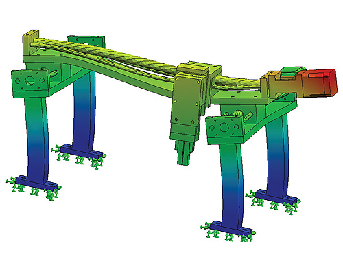

First -pass resonance test. The great value of virtual prototyping is that it allows you to make and correct design errors without the cost and delay of building a physical prototype.

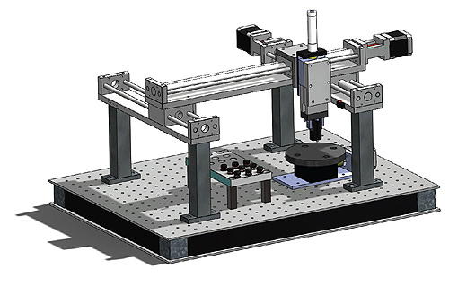

The cornerstone of any machine is its motion profile. At the simplest level you have to get object A from B to C. But in some cases the best way you get from B to C is not always clear: one motion or two? Cams or servos? CAD allows you to quickly layout the moving components of the machine and check for clashes and range of motion. As very few machines start from scratch, the initial CAD assembly is likely to be a mixture of 3D models and layout sketches, or blocks.
Pick-and-Place-assembly-layout
Pick & Place assembly layout
Even with such simple geometry, SolidWorks is able to calculate approximate forces and torques based on the sketch or user defined masses. We can now pass these requirements to the electrical engineer, who can suggest suitable motors and drives. Once more we can take advantage of the software by possibly downloading a CAD model of the motor or drive direct from 3D Content Central (with over one million models) or from a manufacturer’s website.
Pick-and-place-layout-assembly-with-motors
Pick-and-place layout assembly with motors and drives
The first design iteration provides the forces to size the “first guess” motors and drive. With the motor and drive CAD models included in the assembly the motion simulation can be quickly rerun to refine the motor and drive requirements. As the machine design is developed and the CAD assembly becomes more complete, the motion analysis can be periodically rerun, to make sure there are no surprises when the real machine is built.
With the motor sized, attention can turn toward the mechanical performance of the machine and its structure. A typical machine KPI is its positional tolerance, which at a mechanical level, is driven by structural stiffness and drive compliance. For our pick-and-place machine we want a very stiff support structure with a light but stiff moving structure and a drive and coupling system, which is sufficient to meet the needs of the machine. We say sufficient, because motor and drive compliance is intimately related to cost.
Using the integrated simulation suite from SolidWorks we can take the forces and torques from the motion analysis and into a structural simulation to evaluate machine strength, durability and flexibility. Now the mechanical engineer can answer fundamental questions about mechanical performance. Will the machine resonate at any of the operational speeds? Is the machine over-designed? Can we reduce the weight and hence cost of the machine? What is the operational life of machine components? Again these are not one time simulations, rather they are run multiple times evolving and refining as the machine develops, all the time providing the mechatronics team with up to date, accurate information to make informed design decisions. We are now fully engaged in the design iteration loop, the “what if scenario,” which can elevate an “okay” design to a great design.
