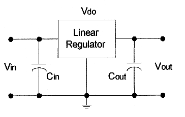

Efficiency: A linear regulator’s power loss comes from the way in which it maintains a constant output voltage. A linear regulator drops a voltage that is equal to the difference between the input and output voltages:  Vdo = Vin – Vout .  Because the output current passes through both the load and the regulator, the power dissipated by the regulator is Pr = Vdo Io:

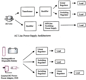

sources of electric power
AC line, external power adapters, batteries, and USB ports are the most common sources of electric power for today’s electronic devices.
Where:
Vin = input voltage
Vout = output voltage
Vdo = dropout voltage
Io = output current
Pr = power dissipated by regulator
Efficiency is critical because wasted power shortens operating time for battery-powered devices and creates heat, which must be removed with a heat sink or a cooling fan. For example, in a classical automotive 5V voltage regulator, more power is dissipated as heat than is used to power the load. The charging system typically generates 14.3V, and the voltage dropped by the regulator to maintain constant output is Vdo = 14.3V — 5.0V = 9.3V. If the load current is 1.0A, for example, the power delivered to the load is 5W, but the power dissipated by the linear regulator is 9.3W.
The simplest 3-lead voltage regulator IC needs only two additional capacitors for stable operation.
Power supply efficiency deals with the input power, power delivered to the load, and power dissipated by the regulator. It can be expressed as a ratio of the output power Pout to input power Pin.  Neglecting the regulator ground pin current (assume  Iin = Io), the approximate efficiency is:
E = Pout/ Pin ,
E = Io Vout / IinVin , or
E = Vout / Vin.
For the example, efficiency E = 5/14.3 = 35%.

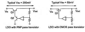

Low-dropout: To increase efficiency and overcome the dropout limitation of conventional voltage regulators, low-dropout (LDO) regulators use PNP or CMOS power transistors. The typical dropout voltage is 200mV for PNP-based LDOs and 50mV for CMOS devices.
Many newer LDOs have extremely low quiescent current, which can be neglected. Then, to calculate efficiency:
By using PNP bi-polar or CMOS pass transistors, LDOs drastically reduce the dropout voltage. Low dropout voltage is an advantage in battery powered equipment when maintaining regulation while the battery is discharging almost down to the regulated voltage. It lengthens the discharge time of the battery and increases overall efficiency of the power supply.
E = Vout / Vin
Similar to a conventional linear regulator, the minimum input LDO voltage should be greater than Vin = Vout + Vdo.  Because the Vdo is so low, the LDO efficiency can be quite high.

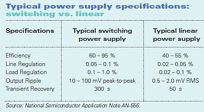

Compared to linear technology, switching power supplies have higher efficiencies, lower heat dissipation, and higher power density. But line and load regulation are not as good as linear regulators, and due to their switching operation, they produce higher levels of EMI. They are also more complex than the linear regulators and require an inductor, which many designers typically dislike. Because these regulators convert voltage from one level to another, they are often called converters.

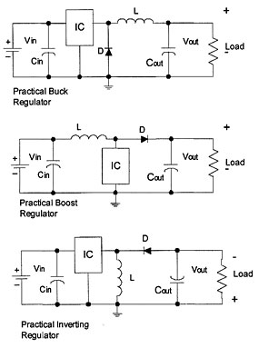

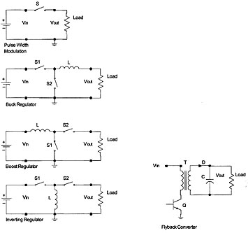

Although other variations are available, Buck, Boost, Inverting, and Flyback topologies are the most commonly used switching regulators.
Switching voltage regulators come in various topologies, which include pulse-width modulation (PWM), Buck, Boost, Buck-Boost, and Flyback. Some convert the voltage, such as a Boost or reverse-polarity power supply.
PWM/Buck: The oldest method, pulse-width modulation (PWM), controls the average load voltage by changing the duty cycle while operating at a fixed frequency. By comparison, Buck dc-dc converters, also called step-down switching regulators, use an inductor connected on the output side to average the voltage. The output voltage is lower than the input voltage and has the same polarity.
Boost: The output voltage of a Boost or step-up converter is greater than the input voltage and has the same polarity. The inductor in this case is connected to the input terminal and is constantly switched between the ground and the load. Without a transformer, only switching power supplies are capable of increasing dc voltage.
Buck-Boost: When the inductor is connected to ground and switched alternately between the input and output, the voltage polarity inverts and can be used to maintain the voltage magnitude higher or lower than the input voltage. Such converters are called Buck-Boost or inverting switching regulators. Only switching power supplies can change polarity and magnitude of the dc voltage.
Flyback: A Flyback converter is the main element of an off-line switching supply. This type of power supply needs only a rectifier at the front end to connect directly to the 110V/220V line. The inductor is replaced with a high-frequency transformer to electrically isolate it. Because of its high switching frequency, the transformer is much smaller and lighter than a 50/60Hz transformer. This type of power supply is commonly used in desktop computers and other office equipment.
A practical switching regulator circuit, at a minimum, requires an input capacitor to maintain a steady input voltage, an output capacitor to filter the ripple current and maintain the dc voltage, a diode to replace one of the switches, and a switching regulator IC with an internal or external switching transistor.
The simplest practical Buck, Boost, and Inverting switching power supplies consist of a regulator IC, input and output capacitors, an inductor, and a rectifier diode.
With the exception of the Flyback circuit, the first three topologies operate in a similar fashion by storing energy first in the inductor L and then transferring it to the output capacitor Cout. Either an external pass transistor or an internal transistor of the switching voltage regulator IC turns on and off by the controller circuitry to maintain the preset voltage across the load. In the boost circuit the ultra-fast rectifier D quickly charges Cout and blocks the current from flowing back into the regulator.  In the buck regulator, D, L, and Cout provide a path for current to free wheel after the pass transistor turns off.

The common 5V supply bus that originated with TTL logic has long been the most widely used regulated voltage. The switching power supply efficiency at 5V and above is superior to that of linear power supplies. The newer 3.3V standard voltage, which replaces the 5V bus, brings the efficiency of the switching and the LDO power supplies closer together. As new devices operate at even lower voltages, switching power supplies lose their efficiency edge and new LDOs that require considerably less filtering and produce low noise might be the better choice for new designs.
