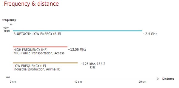

Contactless credentials can be divided into two categories: soft credentials that include mobile phone apps transmitting data via BLE (Bluetooth Low Energy) or NFC (Near Field Communication), and hard credentials that typically include low-frequency (125 kHz) and high-frequency (13.56 MHz) passive RFID transponders. Security concerns are fostering interest in these sorts of credentialing. Consequently, OEMs and system integrators increasingly must understand subtle aspects of how to choose an appropriate RFID reader.

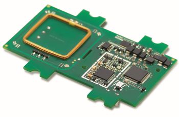

The reader
The reader itself is typically just a small piece of the puzzle. Usually, the embedded product connects to a host that runs its application which interacts with a back-end system or database. Some instances require a matching of credential IDs that are already part of the end-user database or active directory. In systems where the host application cannot manipulate the reader data, the reader must be able to format its output to help match the credential ID stored in a database.

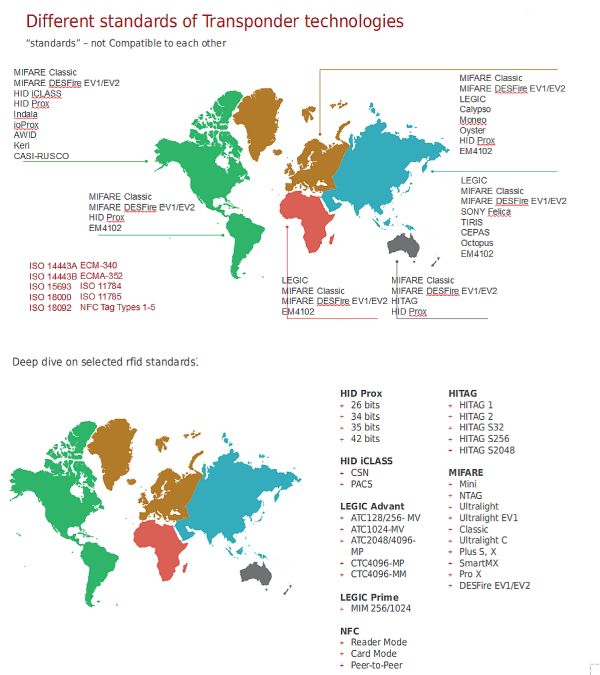

There are numerous RF standards and technologies that apply to RFID. Examples include ISO14443A/B, which defines contactless 13.56-MHz cards used for identification and their transmission protocols; ISO 15693, which applies to vicinity cards, cards which can be read from a greater distance as compared with ISO 14443 standard-based cards, and low-frequency cards also widely referred to as “Proximity cards” or Prox cards that may use different modulation schemes such as FSK (Frequency Shift Keying) and ASK (Amplitude Shift Keying).
Here the reader typically provides power to the card via a wireless connection. Examples of RF technologies used in this area include NFC HCE (NFC Host Card Emulation, where an electronic appliance such as a smartphone behaves exactly as a contactless smart card), ordinary passive EM4x02 and Prox tags which operate at 125 kHz, and HITAG tags that also operate at 125 kHz but are memory based. The reader must be able to fully support all such transponders.
RFID readers must not only detect these varying card technologies but also read their data and interact with them. For example, a UID (unique identification number) may serve as a credential ID and in some instances. Memory-based transponders may store the credential ID in their memory. Here the reader must read not only the UID but also the memory segments of the transponder.
