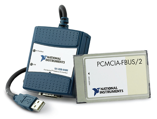

PCMCIA-FOUNDATION-fieldbus-interfaces
NIVarious USB, PCI, and PCMCIA FOUNDATION Fieldbus interfaces can control Fieldbus networks from LabVIEW.

FOUNDATION Fieldbus
FOUNDATION Fieldbus is a bi-directional serial communication protocol commonly used in process automation. It uses a system of distributed control with intelligent devices, where the control schedule can be downloaded onto the devices instead of a central control system. Of its two versions, NI interfaces support H1.
The USB-8486, PCI-FBUS, and PCMCIA-FBUS series interfaces connect these fieldbus’s devices to standard desktop, industrial, and notebook PCs. With the PCI-FBUS, an IPC can act as the host within this protocol system. Use the USB-8486 and PCMCIA-FBUS for portable data logging and in-the-field configuration and maintenance of devices and networks.
