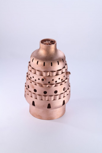

Well, to be honest, copper is no different than other materials when it comes to additive, so I would say many standard benefits that additive manufacturing offers to other materials still do apply. I can go for better design, better functional integration, supply chain robustness and so on and so forth. I think what we are also quickly realizing is that we can do much finer detail resolution with copper, especially with additive manufacturing, depending on layer thicknesses, depending on laser spot sizes, and it’s beyond what traditional manufacturing can do today. Plus, of course, if you count the amazing possibilities that the new alloys offer, not just in terms of pure copper but talking about traditional alloys like copper chrome zirconium, or we’re talking about NASA alloys like GRCop-42 and 84, GRCop-42 being the rage in the space industry right now. This is just beginning of how we are going to shape the copper story.
And I think copper itself is going to lend a very distinguished mark on the AM side of things as we all know that additive began with aerospace and medical and now it’s taken off, especially on the space side. If we’re talking about space, the concepts of regenerative cooling, the concepts of aerospike engines, the concept of RDRE engines, they’re all possible through additive manufacturing. If we talk about regenerative cooling, it’s not a new concept. Traditionally, you had straight through drill holes through chambers and liners to be able to cool the part, but now to be able to go around the part in a spiral fashion that’s hugging the geometry of your thrust chamber, your liners, you’re getting much more efficient cooling. Same goes for aerospike engines. They are decades old technology that NASA did, but nothing really happened with them until… Companies are starting to explore them right now because additive is offering a way to produce these kinds of hardware reliably and more economically.

Copper being copper is very exciting and unique in the way that it runs typically much hotter than other materials. By that, I mean is that you have to put a lot more energy in to be able to sustain a stable melt pool. Now the thing with copper is, the more heat you put in, the more heat it dissipates away because it’s an excellent conductor of heat. So that’s where the challenge comes from copper, to be able to manage that, to be able to manage a general melt pool. In general, the heat input or the laser power or other factors required to melt copper reliably result in the copper melt pool being slightly larger than that of other materials. But like I said, but with the advancements in software process and material innovations, new things are becoming possible where we’re trying to see, can we push the limits and go with wall thicknesses of less than 150 microns on pure copper? That would really change the game on the heat exchanger side of technology or application.

Yes, Yes and no. I mean, copper, like I said, is very challenging and it’s one of the more exciting materials. So historically when people looked at materials and process parameters, it was really easy for them. Say people have an M 290 and they had a parameters on an M 290. Now they wanted to go to an M 400-4, which is a larger machine. What many people do today is, take the parameters that are available on the 290 and then just transfer them one to one and just do minor modifications and you’re at a pretty good starting point.
But that doesn’t work with copper. So because of the highly conductive nature of the material, the process window changes from machine to machine because you have a smaller build plate on the M 290, which is 250 mm, so it’s a smaller heat sink, versus a larger plate on the M 400-4, which is 400 mm and it’s a larger heat sink, so you have to compensate for that in terms of process parameters. So that’s where one challenge is, that process development for copper for different materials essentially means that you’re kind of starting from a little bit farther from scratch. But yes, not like other materials.
