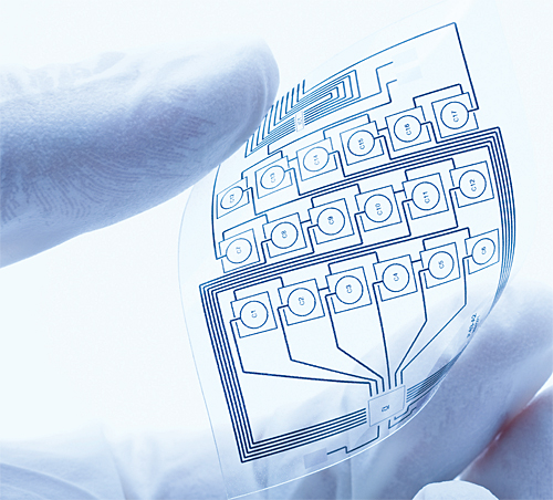

toughened-epoxies
Toughened epoxies feature crucial performance properties that meet the needs of applications in a range of industries.
