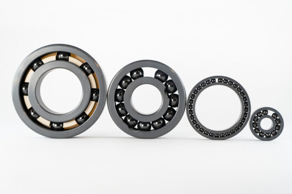

Ceramic bearings offer exceptional resistance to corrosion and temperature extremes, making them ideal for compact, high-performance aerospace applications.
