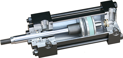

Machesney Park, IL – TRD Manufacturing, a Bimba Company, announced the introduction of the new MH Series and TAS Series Cylinders designed to deliver more reliability in heavy-duty industrial operations.
MH Series
The MH Series are medium pressure hydraulic cylinders rated for 675 to 1500 psi (depending on bore size). The TAS Series Steel Pneumatic Cylinders are rated for 250 psi air and 400 psi hydraulic (with TH option). Both models are available in bore sizes 1.50”, 2”, 2.50”, 3.25”, 4”, 5”, 6” and 8”.
TAS Series
Standard features include a heavy-duty rod wiper, seals, wear band, chrome plated I.D. tube and more. Rod locks, stop tubes, center supports, stainless steel piston rods and high impact pistons are also available as performance options. Accessories include clevis, pins, mounts and alignment couplers, with up to a 5” thread size.
