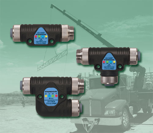

TURCK introduces 7/8-16UN minifast tees, splitters and in-line diagnostic devices, designed for use in DeviceNet applications, including CAN networks and mobile equipment. Models are available in a standard option for classic DeviceNet use and a voltage-monitoring version that contains an integrated circuit board to serve as a diagnostic tool. Voltage monitoring tees and splitters help troubleshoot and prevent downtime with LEDs that report normal, over-voltage and under-voltage conditions.
The splitters provide parallel wiring, which simplifies installations. The ‘h’ configuration contains a tee connected to the main trunk line with one pre-molded cable drop, providing a quick, convenient and space-saving way to add additional cabling within the cable tray. The splitters may be specified with any gender negating the traditional male to female connection requirement. Additionally, the in-line diagnostic devices may be used as gender changers to connect a male-to-male or female-to-female cord set.
Designed to accommodate diverse conditions, the minifast splitters and tees can handle up to 30 volts in temperatures ranging from -40 to 105 degrees C. The splitters and tees also feature an IP67 environmental protection rating, providing an ideal solution for voltage trouble spots in harsh conditions.
