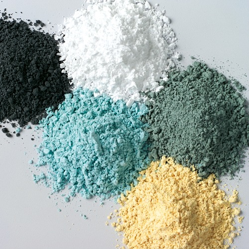

FT. WAYNE, IN – Trelleborg Sealing Solutions announces that Turcon‚® MF6 compound has been listed by NSF International as conforming to the requirements of NSF/ANSI Standard 51 – Food Equipment Materials.
Turcon‚® MF6 is part of the Turcon‚® MF range of materials specifically engineered for demanding processing environments, including food and beverage production. Based on ultra-clean technology, these proprietary compounds are manufactured from high-purity PTFE grades and additives. Their smooth finish, with high gloss and low porosity, avoids the risk of contamination buildup and reduces particle shedding. Each batch of MF material is manufactured using high-purity material only and can be issued with a certificate of conformity.
The Turcon‚® MF6 PTFE based material offers:
*Operating temperatures from -200‚°C /-328‚°F to +260‚°C /500‚°F
*Almost universal chemical compatibility
*Outstanding low long-term compression set characteristics
*High wear resistance
*Minimal creep and permeation
*A surface finish that minimizes contamination risk
*Performance in a broad range of chemical media including organic and inorganic oxides, acids,
alkalis, amines, esters and steam
*Compliance to FDA 21 CFR177.1550, 3-A, USP Class VI and sanitary standards
*NSF/ANSI Standard 51
The materials are available as Turcon‚® Variseal‚®, a spring-energized sealing element, or in other custom profiles.
