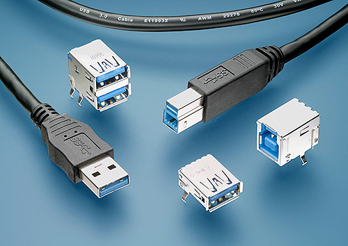

With such requirements in mind, Tyco Electronics (TE) releases a new USB 3.0 connector, which has retained all the great features of previous generations of USB interconnects while improving upon them in the areas of performance and power management.
Tyco-Electronics-USB-3-0-Connector-
TE’s USB 3.0 connector meets all standards of USB-IF. It supports 5 Gbps data rate for a fast “sync-n-go”, offers a 10X performance increase over USB 2.0, which makes downloading HD movies faster. In addition, the USB 3.0 connector is backward compatible with USB 2.0 while offering optimized power efficiency by eliminating device polling and reducing active and idle power requirements.
The connector allows for the unit load of 150mA (which is a 50% increase over the minimum unit load of USB 2.0) up to six unit loads (which is 900 mA, an 80% increase over USB 2.0 at a registered maximum of 500 mA). This means that USB 3.0 has up to 80% more power capacity based on the configuration of the device.
According to the USB-IF, the standards body controlling the USB specification, the USB connector is the most popular form of interconnect in the consumer electronics marketplace today — based on broad proliferation, versatility and ease of use. This interconnect clearly found its place in the PC and PC peripheral arena and can be found in nearly every consumer device produced in the last decade.
In the near future, TE plans to offer a full line of certified USB 3.0 product solutions. This portfolio includes various configurations of Standard A and B style plugs and receptacles; powered B plugs and receptacles; Micro B and AB plugs and receptacles; and cable assemblies. Various stacked and combination variations are expected to round out the TE USB 3.0 portfolio.
