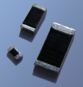

The UHV series from Stackpole offers extremely high voltage ratings per package size.
* UHV2010 rated up to 6KV
* UHV2512 rated up to 10KV
* UHV3512 rated up to 12KV
* UHV4020 rated up to 16KV
* UHV5020 rated up to 20KV
In addition, values of 500M, 1G, and 2G are in stock in sizes from 2010 to 5020, which are ideal for use on the high voltage side of a high voltage divider network. Resistance range for the UHV series is from 100M up to 10G in TCR of 100 ppm and tolerances as low as 1%.
The UHV is ideal for high voltage medical applications, voltage dividers, high voltage power supplies, avionics and aerospace, industrial equipment, and telecom infrastructure and equipment.
