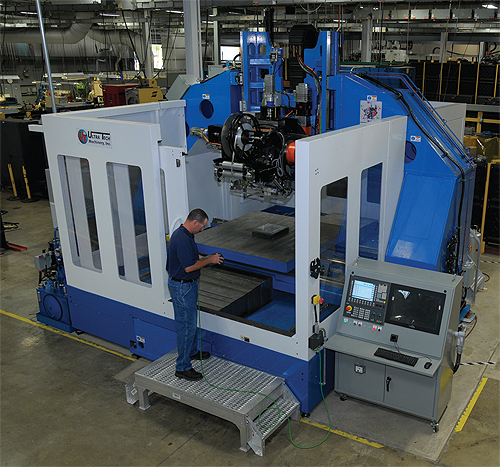

A common problem with sensors is that they degrade over time because of corrosion, impact and wear. It would be better to house them in solid metal for protection and long operating life. However, conventional manufacturing technologies make such a process difficult. Using high temperatures in certain processes damages sensors. A new process, called ultrasonic additive manufacturing (UAM), can help house sensors in protective metal housings—without damage.
UAM is a solid-state 3D printing process for metals that uses sound waves to merge layers of metal foil. The process produces true metallurgical bonds with full density and works with a variety of metals, including aluminum, copper, stainless steel, and titanium. By combining additive and subtractive processes, UAM can create deep slots; hollow, latticed, honeycombed internal structures; and other complex geometries—geometries impossible to replicate with conventional subtractive manufacturing processes. Additionally, because the metals do not have to be heated for bonding, many electronics can be embedded without damage. This enables sensors, communication circuits and actuators to be embedded into fully dense metallic structures.
Many sensors such as thermocouples, pressure transducers, accelerometers, and strain sensors have been successfully integrated into UAM built components. For instance, fiber optic Bragg gratings have been embedded in aluminum parts for precise strain measurement. Similarly, traditional resistance strain gauges have been embedded to build structures with integrated health monitoring capabilities. Fluidic devices have been built with integrated valves, pressure transducers and check valves. Fiber optics and small diameter sensors/wires can also be encased potentially without machining.
