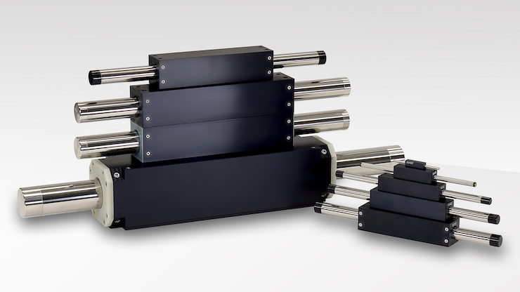

Linear motor actuators
Linear motor actuators are direct-drive solutions that contain no mechanical transmission elements. The load is connected directly to the carriage assembly and is moved by the linear motor itself. Linear motors are available in a variety of types, including iron core platen style, ironless T- or U-channel style, or tubular style. Linear actuators are typically based on a BLDC servo motor and use linear encoders for position and commutation control.
Depending on the application requirements, the more compact and efficient linear motors are potential alternatives for belt or screw-driven actuators and pneumatic or hydraulics systems. They are particularly excellent choices for multi-axis cartesian or gantry systems where fast move and settle times and precision is important. Linear motors are capable of high speeds and quick accelerations and are typically only limited by the available current and capabilities of the linear rails to which they are mounted. Linear motor systems are inherently compact, as many transmission elements are eliminated, and can be constructed with low profiles for space saving requirements. With reduced energy consumption, efficient linear motors, and the elimination of hydraulic fluids, linear motor actuators are an environmentally friendly approach.

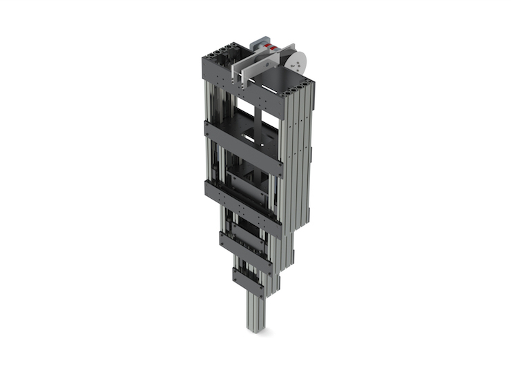

Telescoping actuators
Telescoping actuators are similar to the rod style actuator but are designed to expand to two to three times their collapsed length through imbedded segments within the actuator body. These actuators are typically used in vertical lifting applications to extend or retract a load. They can be screw or belt-driven with servo or stepper motors. Pneumatic and hydraulic systems are also a possibility with telescoping actuators.
Telescoping actuators are typically used in vertical lifting applications to extend or retract a load.
Typical applications are to raise and lower various loads or to insert or retract parts into another machine process. Depending on the actuation technology, the telescoping actuator can handle mid-load ratings and may use screw or belt actuators to provide rugged designs and extended life. The telescoping actuator is not ideal for horizontal applications due to potential moment load deflection when fully extended.
