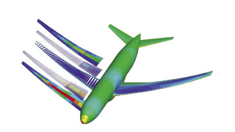

Dr. Joaquim Martins, along with PhD candidates Rhea Liem and Gaetan Kenway, recently published their research on the optimization of aircraft wings. In their paper, titled Multi-point, multi-mission, high-fidelity aerostructural optimization of a long-range aircraft configuration, they use the example of a Boeing 777, and show how an optimized wing design could cut the plane’s fuel burn, for all of its flights, by an average of 8.8% .
Consider that result for a moment: Boeing is no slouch when it comes designing wings to start with, so beating them by 8.8% is dramatic.
Wing design is an interesting case: the basic architecture of an airplane’s wing is usually established very early, during the conceptual design phase. The wing defines the essential characteristics of the airplane, and constrains many other design decisions. The thing that makes wings so hard to design is that their aerodynamics and structure are not just interdependent, they’re variable. “The wing is flexible, so even though you build it with a certain shape, it deflects and has many different shapes depending on the flight conditions, said Martins. “If you’re just doing aerodynamics, you’re not really considering that.”
Optimization of airplane wings is not a new concept. Some of the early research in this area dates back to 1977, when R.T. Haftka worked on the optimization of flexible wing structures subject to strength and induced drag constraints. Research has continued through the years, directed towards minimizing fuel burn.
The aim of Martins and his team’s research was to design a long-range aircraft configuration that was fuel-efficient in all expected flight conditions. Key to accomplishing this was the use of historical data on 100,000 Boeing 777 flights, from which they created a set of representative flight missions incorporating multiple flight conditions (e.g. takeoff, climb, cruise, descent, and landing.) This multi-point approach provided a more accurate profile of fuel burn compared to a single-point analysis considering only one flight condition.
airplane-optimization_opt
Some previous research on multi-point optimization of aircraft wings suffered from the use of 2D analysis or 3D analysis without aerostructural (simultaneous aerodynamic and structural) analysis, and the use of arbitrary weights to combine the operating conditions into a single objective. In this work, the researchers used 3D high-fidelity FEA and CFD analysis, enabling them to model the underlying physics more accurately and with fewer restrictive assumptions. And, by using historical mission data, they were able to determine the best weighting for a multi-point optimization, without resorting to guessing.
One of the significant factors holding back the widespread adoption of MDO is its computational cost. The use of high-fidelity models can raise the cost from merely expensive to unbearable. Parallelism is a lifesaver, but it can’t overcome computational inefficiency.
A good approach to gaining computational efficiency, which the Martins team used, is the surrogate model method. This involves using sampling to create a model (variously called a surrogate model, response surface model, or metamodel) that’s a “good-enough” representation of the high-fidelity discipline model within the expected range of conditions. The methods used to create surrogate models is a subject that only mathematicians could love. In this project, the researchers used the Kriging approximation, a statistical interpolation method that is popular in MDO.
Academic researchers tend to like to use academic (rather than commercial) CAE codes. For Euler CFD, the researchers used SUmb, a multi-block structured flow solver from the Stanford Center for Integrated Turbulence Simulations. For FEA, they used the Toolkit for the Analysis of Composite Structures (TACS) from the University of Toronto Institute for Aerospace Studies.
MDO professionals wax rhapsodic when talking about optimization methods. The simple rule you need to remember is that there is no perfect method. No method is guaranteed to find the global optimum for a general problem. Gradient methods can reliably find local optima, but may be unable to escape a local optimum. Stochastic methods will find a good solution, but it may not be the best solution. The Martins team chose the coupled adjoint method, which allowed them to efficiently compute gradients of functions with respect to hundreds of design variables. To implement this, they used SNOPT, an algorithm from Stanford.
The optimization model used a relatively coarse 1.2 million cell CFD mesh and a finite element model with 300,000 degrees of freedom. After completing the optimization, the analysis was re-run using a 2.1 million cell CFD mesh, to get more accurate results.
The optimization was run at SciNet, University of Toronto’s high performance computing facility, on a massively parallel supercomputer. It took 48 hours to complete 138 major iterations to get the optimal design.
