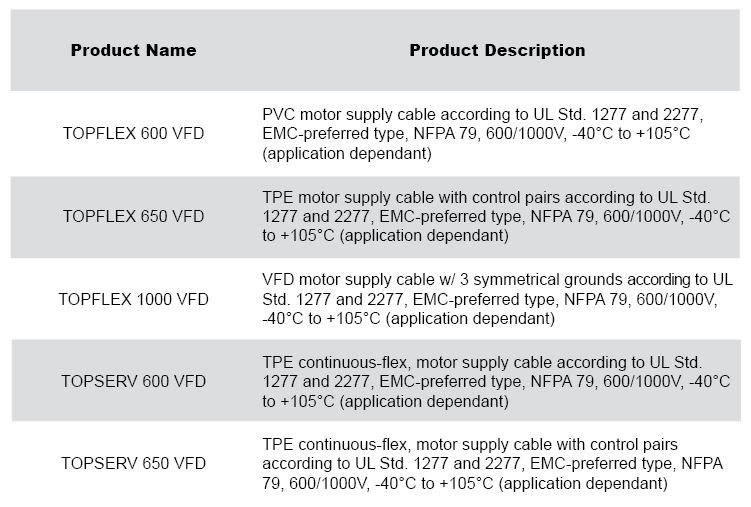

HELUKABEL’s TOPFLEX and TOPSERV VFD cable products have upgraded their conductor insulation material to XLPE from PVC/nylon to stay ahead of the curve as the industry transitions towards a future electrical installation code update that requires the use of RHH, RHW, RHW-2, XHH, XHHW and XHHW-2 insulation to comply with NFPA Chapter 12. The product specific cable types upgraded are: TOPFLEX 600 VFD, TOPFLEX 650 VFD, TOPFLEX 1000 VFD, TOPSERV 600 VFD and TOPSERV 650 VFD. HELUKABEL believes that the requirement for thermoset conductors in VFDs may be a shift in the market rather than a real concern for safety when comparing the benefits of thermoset over thermoplastic insulation in terms of premature insulation failure. This is because voltage spikes, overload and inrush currents can be handled for long durations by thermoset insulation without premature failure by using properly sized cables (using 125 percent FLA), and would further be safeguarded by the circuit protection device used in the system (circuit breaker or fuses).

XLPE upgraded products
