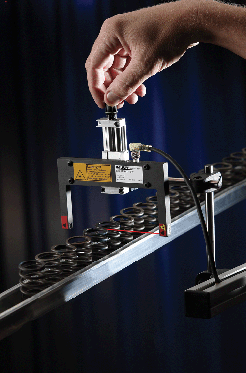

Misalignment, vibration, and mechanical hits are no longer a concern in some applications that use new “L” and “U” shaped infrared, red emission, and laser,self-contained thru-beam units because these sensors straddle the detection area.

New “L” and “U” shaped infrared, red emission, and laser, self-contained thru-beam units are conducive to many error-proofing applications such as part presence, height verification, or feeder bowl part flow verification. If the emitter and receiver are built into a rugged metal frame, you can straddle the unit over the detection area without concerns about misalignment, vibration, or mechanical hits.
