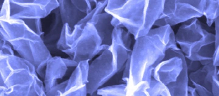

Six years ago, Jiaxing Huang discovered crumpled graphene balls — novel ultrafine particles that resemble crumpled paper balls. Image credit: Jiaxing Huang

The solution lies in a scaffold made from crumpled graphene balls, which can stack with ease to form a porous scaffold, due to their paper ball-like shape. They not only prevent dendrite growth but can also survive the stress from the fluctuating volume of lithium. The research was featured on the cover of the January issue of the journal Joule.
“One general philosophy for making something that can maintain high stress is to make it so strong that it’s unbreakable,” said Huang, professor of materials science and engineering in Northwestern’s McCormick School of Engineering. “Our strategy is based on an opposite idea. Instead of trying to make it unbreakable, our scaffold is made of loosely stacked particles that can readily restack.”
Six years ago, Huang discovered crumpled graphene balls — novel ultrafine particles that resemble crumpled paper balls. He made the particles by atomizing a dispersion of graphene-based sheets into tiny water droplets. When the water droplets evaporated, they generated a capillary force that crumpled the sheets into miniaturized paper balls.
In Huang’s team’s battery, the crumpled graphene scaffold accommodates the fluctuation of lithium as it cycles between the anode and cathode. The crumpled balls can move apart when lithium deposits and then readily assemble back together when the lithium is depleted. Because miniature paper balls are conductive and allow lithium ions to flow rapidly along their surface, the scaffold creates a continuously conductive, dynamic, porous network for lithium.
