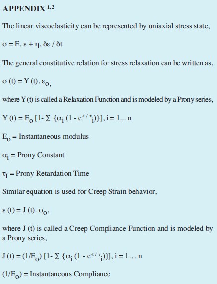

We focused on measuring linear viscoelasticity for the FEA analysis. Linear viscoelasticity follows a principle of superposition where the relaxation (or creep) rate is proportional to the instantaneous stress (or strain). In this case, stress (or strain), when normalized by the instantaneous value, will follow the same variation with time, showing independence to their instantaneous values.
Material models in FEA
The elastomeric materials were modeled in two steps using hyperelastic material models for instantaneous state of stress and using time dependent function, R (t) = [1- ? {ai (1 – e-t / ti)}] as described in the Appendix.
