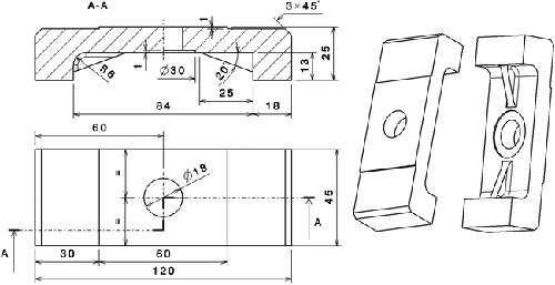

This application shows a FEM analysis of a support clamp, figure 1.
Fig. 1 — Support clamp (all dimensions in mm)

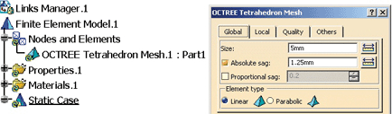

The analysis uses the CATIA program. After the solid modeling in the CATIA Part Design module, the user defines a material (steel), having the following physical characteristics: Young modulus (2_1011 N/m2), Poisson ratio (0.266), density (7,860 kg/m3) and yield strength (2.5_108 N/m2).  Next, in the CATIA Generative Structural Analysis, the user establishes a Static-Case analysis and defines the node and finite-element net, in a process called discretization. In this process it is highly recommended to edit the default net parameters, defining the new finite-element size (5 mm) and type (linear), the absolute sag (1,25 mm) between the model and the real part, etc. To do this, the user must double-click the subelement “OCTREE Tetrahedron Mesh”, found in the specification tree, as shown in figure 2:
Fig. 2— The discretization process of the part.

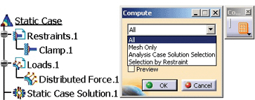

Next, the part is constrained, figure 3.
Fig. 3— The application of the Clamp constraints.

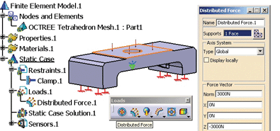

The specification tree is completed with the subelement “Clamp.1”. The dialog window contains in the “Supports” field two faces, marked on the part model. On the part’s superior and functional surface, a 3000-N distributed force is applied perpendicular to the surface, in the opposite direction of Z axis. The specification tree shows the subelement “Distributed Force.1”.  The force is symbolized by four arrows on the surface, its value and orientation, and the coordinate system where it was created; all these parameters can be specified in the corresponding fields of the dialog window, figure 4.
Fig. 4 — The distributed force application.
Now, after the constraints and loading case, the next stage is the analysis computation, launched by pressing the “Compute” icon. As a result, the dialog window with the same name is opened, figure 5, where the user selects the “All” option, followed by the update of the subelement “Static Case Solution”.
Fig. 5 — Launching the computation.

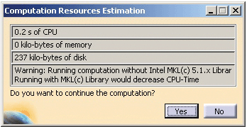

If the user unchecks the “Preview” option, the analysis time is shortened by not displaying the information window “Computation Resources Estimation”, figure 6.
Fig. 6— Computation resource estimation.
However, this window has an important role in very complex analysis processes, because it offers informations about the calculation time and the necessary space on disk.

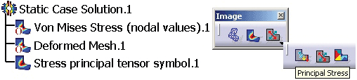

Once the calculus is finished, the user has at his disposal some tools from the “Image” toolbar to visualize the results. The specification tree is completed with different sub-elements of the inserted images. By default, the last added is the active one, by deactivating the previous others, figure 7.
Fig. 7— The Image toolbar and the list from the specification tree.
This shows the specification tree containing a list of three images (and also results) and their icons, as part of the subelement “Static Case Solution”.Next, evaluate the four image results shown in figures 8-11.

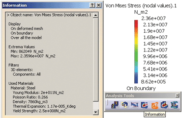

These correspond to the calculations of the mechanical part.  Note that the deformations are graphically exaggerated to simplify drawing conclusions from these images.To find the maximum and minimum tensions (stresses) after the analysis, activate the “Von Mises Stress” result and, from the “Analysis Tools” toolbar, applying the “Information” tool, the program opens an information window with the same name, figure 12.
Fig. 12 — The max and minimum values for stresses. At right is the stress palette.
In this figure, the stresses values palette is shown for the “Von Mises Stress” result. The smallest values for the stresses are in the lower section of that palette, and the highest ones in the upper section. Also, these two extreme values are shown in the information window.
After the analysis ends, the user should compare the yield strength value for the chosen material with the maximum value in the “Von Mises Stress” result. The stress value is almost ten times smaller (2.36_107 N/m2 vs 2.5_108 N/m2), so the conclusion can be drawn: the mechanical part resists or withstands the planned loading.
