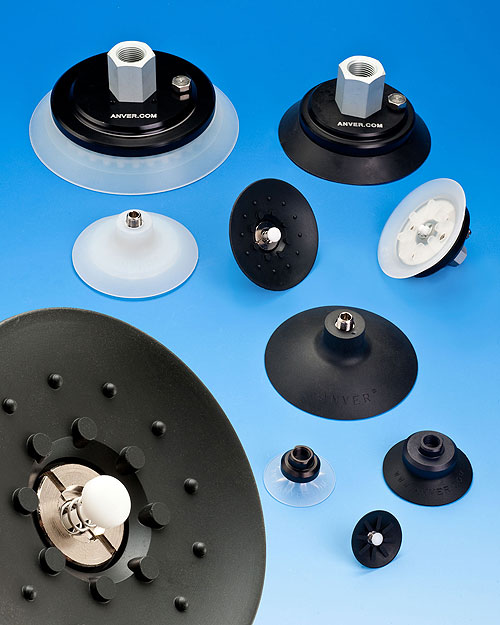

Hudson, MA – Anver Corp. offers a line of vacuum suction cups featuring button probe valves which only open when a cup touches a load to provide faster attach-and-release, while preventing air loss.
Anver-Vacuum-Probe-Cups
Anver’s Vacuum Probe Cups feature button probe valves which remain closed to save air and energy and are actuated when they touch the load, providing faster attach-and-release than conventional cups. Ideally suited for large pick-up arrays used in high cycle automation equipment, they prevent leakage caused by suction cups that missed the load or are not being used.
Maintaining vacuum right at the pick-up point, Anver’s Vacuum Probe Cups are designed for continuous duty. The Delrin® button probe protrudes slightly from the center, is spring-loaded to remain closed, and opens instantly when it touches a load to permit vacuum flow. Applications include packaging lines that pick-up multiple products simultaneously.
